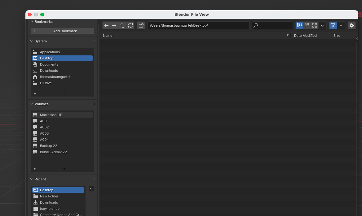

Since (i believe) Ventura they moved Dropbox folderwise into Cloudstorage. I can use Dropbox with the Dropbox App and i can find Dropbox in the Finder by showing all hidden files. But i can't access Dropbox with Blender (save, open, append ect...). Its just not showing up and i cant browse hidden files of course.

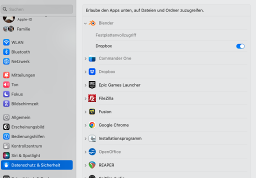

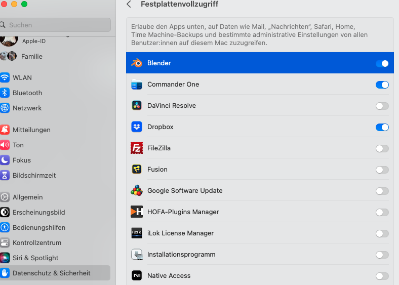

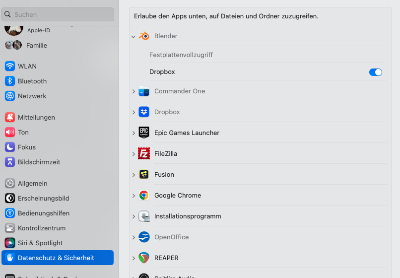

In system preferences, under privacy and safety i gave Blender full permission and under Files and Folders, if i klick on Blender, there is Dropbox enabled appearing.

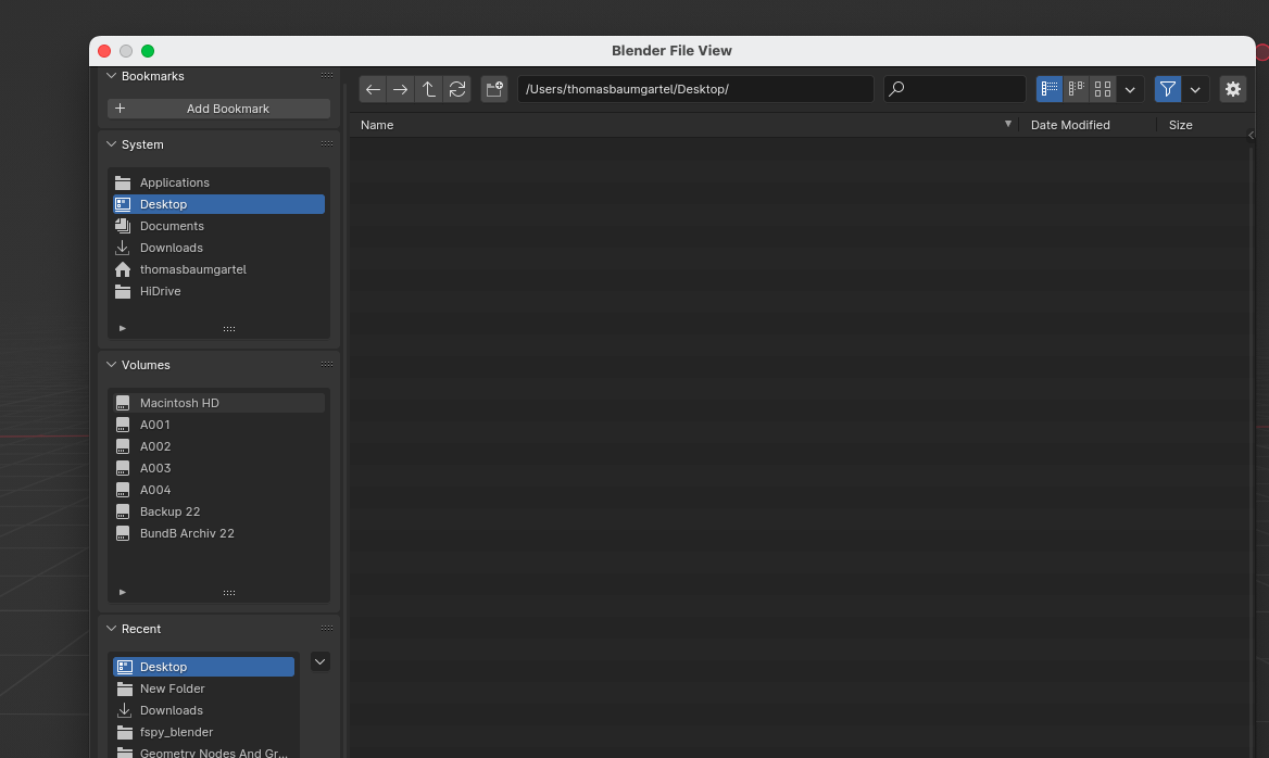

But it's not showing up in Blender itself.

I solved the issue.
In Finder press "command+shift+.". That shows all hidden files. Go to Dropbox (User-Library-Cloudstorage-Dropbox), copy Filepath. Open Blender, go to save as, copy the filepath in and add a Bookmark to that lokation.
Hope thats a real solution...
